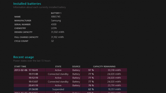

Mine showed 31, 502 for both design capacity AND full charge capacity, with a 32 cycle count, so now I'm wondering if I'm looking in the right place...
I would post a screen shot but for the life of me I can't get it to upload.
"Try from the Desktop browser."
I've tried it from both the desktop UI on the Surface and my desktop computer with no success. I click the "Insert image" icon above the Quick Reply window, browse to the image and select it, then click Upload File(s), but nothing happens. I'm overlooking something embarrassingly simple.
Try advanced post from Desktop, works for me.
