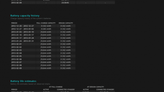

Serious battery capacity decrease
Only 14 cycles yet 27,950 mwh? Is this because you use it a lot while it is plugged in charging?
I don't understand the report and the criteria so I'm not concerned with the results for now. Until I understand the "normal" range and how the battery status is actually determined don't put a lot of stock in the report. Something as simple as a recalibration may be necessary or this could be totally within standard battery variance. If anybody knows more about it please feel free to share, otherwise it is sort of like comparing free RAM on different units.
I tend not to use it too much while plugged in. Mostly unplugged but rarely (if ever) run the battery very low.

Update! I finally COMPLETELY discharged my surface. It self shutdown at 5%, but i found the USB port still had power, so i connected a portable HDD to it. a few minutes later "Surface" showed up on the screen like it's booting but right away it changed to a picture of "a low battery in a circle", after that USB lost power.
Now the full charged capacity is 29548mWh, which is better but still 6% lower.
thanks for the update. that just shows that what you see is not always what you get if you tweak a little ;)
Looks like one big drop then steady so I am guessing a recalibration would help.
