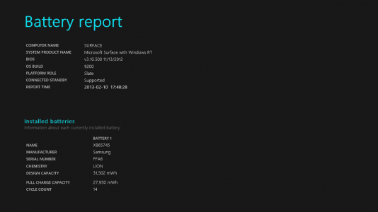

Here you go.
Only 14 cycles yet 27,950 mwh? Is this because you use it a lot while it is plugged in charging?
