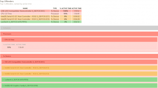

As mentioned in some other threads I have also noticed that since the last firmware update in mid-August, the CPU is very busy in Connected Standby. The result is that I see the following information in stleepstudy report what causes me to lose about 11 percent of battery in an hour. It's the CPU.

My issue was due to HD Graphics according to the sleepstudy report.
After the 8/19 firmware update I did a refresh and everything has been cleared up. nothing currently whacky in the sleepstudy and battery life looking to be longer than ever.
