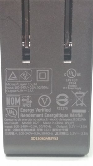

The included charger does 5.2v at 2.5 amps

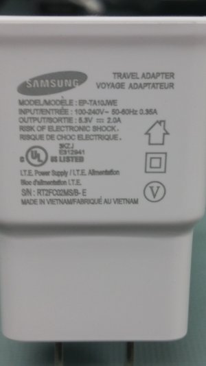

You can use something like this Samsung charger that does 5.3v and 2.0amps
Should get a decent charge out of that.

I used a Samsung 2.0A charger from the original Galaxy Note 10 (results above) that wasn't up to the task, while the ASUS 2.0A charger looks good so far. Both of my brand new 2.1A Battery Packs failed, shutting down after a few minutes so they are going back. The Anker Battery Pack mentioned above seems to work ok but charges a little slower than I expected only giving 2.0A or less but If I put load on the system it will go up to 2.5A and drops back to 1-2 when the load decreases.
