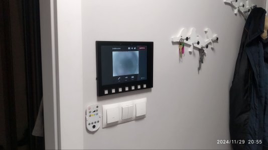

I use Surface Go 2 in a bracket on a wall. Unfortunately, I covered built-in speakers which caused sound to become very poor, so I cannot understand what visitor at the gate is saying. I could not find on any Microsoft specification where these speakers are located. Could somebody point me to any documentation, or show picture with open case to see where exactly these speakers are located. Knowking this I can make notch in my bracket to allow clear sound propagate outside. In the attachment I show how Surface Go 2 hanged on the wall works as my house automation controller (opens gates, switches lights, etc.).

The Surface Go's speakers are on each side of the device, close to the top edge. Each speaker measures approximately 2 mm in width and about 25 mm in length.
There are small, very small, cutouts at the edges of the glass near the top. you can see them easier when holding at an angle.

Thank you very much! I have found them. As you can see on the first picture my Surface Go 2 is mounted on the wall, and I wanted to avoid putting additional speakers on the wall. I supposed build-it speakers should be enough for occasional intercom conversation, and ring bells and alarms from the gates and doors.
Nice setup for home automation! The speakers of the Surface Go 2 are located on the left and right edges of the screen, near the top. If the sound is muffled, making a cut in your medium in these places should improve the audio quality. You can also try a small Bluetooth speaker if the modification of the support is not ideal.
