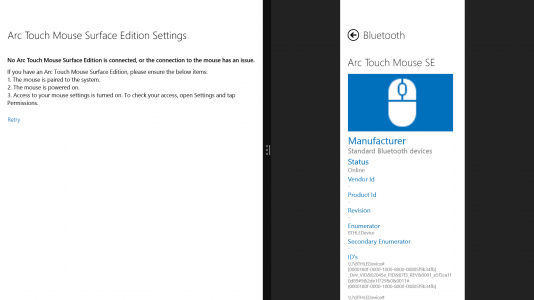

My Surface Pro 2 and Arc Touch Mouse Surface Edition isn't seen by the Arc Touch Mouse Surface Edition Settings Application. Even when I use it to launch the application...
It is however seen by the Surface Pro 2

I have the Surface Pro 2 and the Surface Edition of the Arc Mouse and it is seen and able to be configured by the settings application correctly. It should be prompting you for permission to read and modify settings for the mouse however before it will be able to do anything.

Anyone have luck sorting this out? I am having the same problem. When I run the app, I am not prompted for permissions. The app simply tells me that the device is not detected.

When you open the app, swipe in from the right side to open the Charms menu, then press settings. You should then have a permissions button - does anything show in here?
My understanding from the Microsoft Forum is that Microsoft recognizes this as a known problem and promises a solution, but I assume this is not a high priority because they have known about the bug since the product was released. I just bought one and it is not recognized. I think Microsoft should withdraw the software until it is corrected or at least warn purchasers that the product does not work as advertised.
I have been in contact with surface support today and after going through some fault finding steps with them (Reinstall app,repair,2 button shutdown,custom diagcab) they are going to send me a new mouse. the support guy also told me it was an issue they had heard of before.
