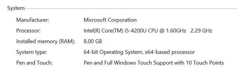

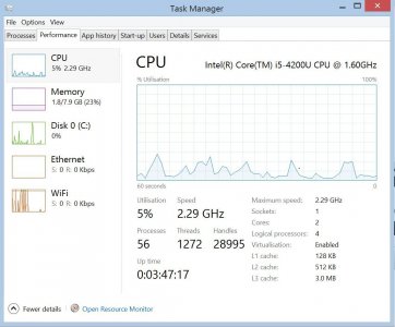

Reefa
Thanks for the replies..
I've attached some images from PC Info and Task Manager, it's definitely 'not in my head', and I'd rather not have to do a restore as my Surface is used heavily for work and I don't currently have the time..

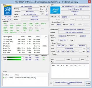

Hi Reefa,
I was curious after your post, so I checked on my 256 SP2 as well.... and sure enough, Windows is reporting the CPU as a 2.30 GHz, and Task Manager is showing a max speed of 2.30. However, when I load HWiNFO64, which I use for all sorts of useful monitoring, it is showing the following:
CPU LFM (Min) 800MHz
CPU HFM (Max) 2300Mhz
CPU Turbo 2600Mhz
Uncore Max 2600Mhz
So, it appears it is simply the way that 8.1 is detecting the CPU speeds. While keeping the HWiNFO sensors loaded and trying multiple task or games, both core #0 & #1 both hit 2595Mhz, which is 2.6GHz. Oddly, task manager only sees this as 2.3Ghz during this same time.
As I type this on high performance mode with several tabs open, I'm watching the cores bounce around between 798-2595MHz.
I wouldn't restore at this point for this issue, you should be just fine. If you want to monitor them closer during actual use, along with anything else you might want to watch, I highly recommend installing HWiNFO 64, it's updated regularly and is free to download and use... I've used it for years on all my machines.

Reefa
Hi be77solo,
Thanks for the heads-up on HWiNFO64, hadn't used it before..
Did some testing using this tool, Prime95 and StarCraft 2, it appears that I also have the same indicated values - specifically Turbo 2600Mhz, but this value is never reached, even in high performance mode. It seems that the ThermMon kicks in and limits the ratio at x23. It occasionally pops up to x26 for a millisecond and goes back down, with ThermMon indicating 'Throttled' for that brief moment.
Perhaps this was an additional battery saving feature added to the firmware update or maybe it's an Intel Turbo Boost modification to keep the temps down. At any rate it's good to see that it does attempt to reach the maximum clock and gets held back by thermal monitoring.
