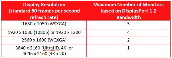

That is right. It's 4 display in total, at 1920x1200/1920x1080.
Higher the resolution, the less displays you can plug. If each screen is 800x600, you can plug a bunch of them.
DisplayPort shows this table:
But would I be correct in saying that the limitation is not the DP...its the SP3 GPU.....hence only 3 displays can be active due to the 4300 GPU
Hard to say. Intel HD4400 (what is in the U4300 CPU), can only do 4K 30Hz, not 4K 60Hz, like what DisplayPort 1.2 can do. So, the limited bandwidth from the Intel GPU can play a part.
