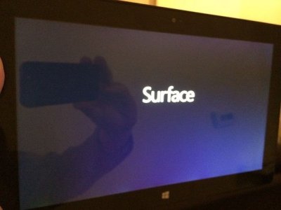

Surface RT No longer starts after latest update

Is there a proper way to talk when you spend more per hour of use on a 450$ tablet than a 40,000$ truck? Here is a picture of the screen for you. This is where it is stuck.

1. It appears my SSD has failed. This may have been why performance was extra poor before the final update as well. When your SSD fails you are unable to boot from the USB or get past this screen.
