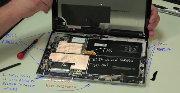

My thoughts:
I watched the excellent "Cracking Open" video C-Net made:
You can clearly see at 1.50 minute the area where the screen seems to pop-out.
Here is my quick analyse:
The area where the screen pops-out is definitely the area where the warmest air is extracted from the inside by the fan.
By the way, this area, where the antenas are, has less adhesive than the sides of the chassis for example. It's a weak point.
Now, if you look to the SP3, you can clearly see that the screen is a little curvated towards the inside. This curvature obviously creates tension stresses on the adhesive. Because the glass is probably not curvated, and naturally wants to pop-out.
The adhesive properties of the tape are certainly affected by the heat, particularly where the air is warmer, i.e. right above the fan.
All these things combined together make this area of the screen a good candidate for popping out.

This isn't normal - but Remi, where you labelled 'heat extraction' is actually the intake. From there, the fan distributes the air across the Surface and out of the other vent holes.
@Liam2349 I am not sure about your statement.
The situation you describe would spray warm air all over the SP3:
The situation I describe would suck in fresh air from the outside and push out the warm air:
Outside Air is pulled in through the vents and cooled via the fan and heat pipes to be distributed across the rest of the Surface interior...as Liam stated....
