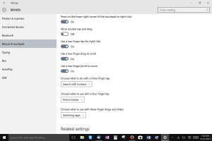

I am running:
Windows 10
Version 1511
OS Build 10586.36
Mouse and touchpad Settings:

Mouse and touchpad Settings:View attachment 7697

Try matching my settings, and see if you still have the same problem.
Even with matching settings, I still get unpredictable pinch/zooming. Can that be set to a lower sensitivity somewhere?
