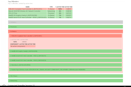

What does the Sleep Study say? I would do a factory reset and test it again before I would return it personally....
maybe it's sd card ,as above people ,I took out the sd card last test, and sleep 1.5 hours cost 15% battery
It is either the SD card or possibly a bad keyboard cover as both are USB based....
Thanks,I took out the keyboard ,and try it again, see what happens, probabely is keyboard, sometime it loose.
