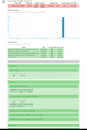

What's going on ,4 hours sleep costs 20% battery
attached the keyboard ,and test 1.5 hours ,3% drain,seems ok now, thanks jeff and other friends.

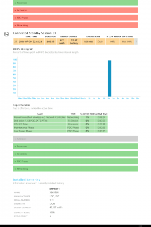

This thread had me curious so I left my sp3 unplugged last night. At about 9:50pm I was at 84%. This morning at 6:10am, I was at 82% (at 81% after just a minute or two of use). Looks like I am about working as expected.
The new firmware seems to fix my sleeping battery's problem, put it sleep for 4 hous just drained 1% battery ,pretty impressive.
