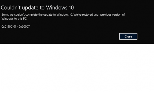

Can someone help me through this? I don't want to have to reset my surface.
I am running Build 10074 and my system is trying to perform an update to 10122. However, it's failing at the install screen (you know, with the big % in the middle and circular progress bar?
It's stopping at 18%. Down at the bottom in the Copying Files progress, it is stopping at 62%. I have tried redownloading my updates and did a 2nd attempt, and it still failed. It's stopping at the same exact spot. I wait like 10-15 minutes in case it is just taking a long time and force a power down, it then recovers my previous version of Windows. Im attaching a screenshot of the error message when I log back into Windows.
I didn't see which surface you had, but gabe aul posted this:
SP3 users who are getting rolled back on upgrade to 10122, try from CMD:
rundll32.exe pnpclean.dll,RunDLL_PnpClean /DRIVERS /MAXCLEAN
Also, make sure you run this command from an elevated CMD Prompt...

The CMD fix did not work for me (Surface Pro 3, 8Gb, 256 Gb, i7), I stay stuck in the 10074 : does anybody know when the 10125 release is planned ?

Hey all, thought I'd check back in here. So I finally got it working! The problem? When running the rundll.exe command as the fix suggests, it doesn't give you an error message if it isn't being run in an Administrative cmd.exe shell. What was happening was I was just typing in cmd.exe and starting up a prompt that way. I should have right-clicked on cmd.exe and hit RUN AS ADMINISTRATOR.
Once I did that, the command ran (again) with no success or failure message. Ran the update and it worked!
Or.. Maybe it was just good luck from running it while at a Microsoft store :) Thanks everyone! Loving 10122!
