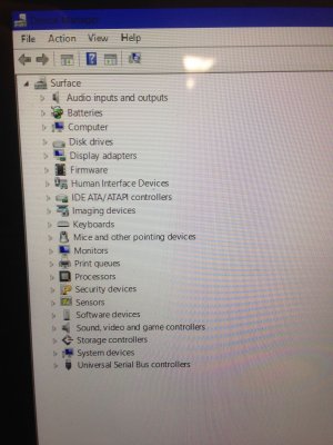

Sharpcolorado, thanks for your reply. This is not good; I'm not finding Network Adapters in Device Manager...
Your Surface Pro 3 may have fried its NA. Lets hope not.
Try searching for new devices (Action, Scan for hardware changes)

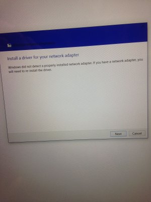

Just wanted to give a little update. When I go into Network & Internet, then click "show available connections", it says "no connections are available" (this is old news). But when I click Troubleshoot, I get the following message:
"Install a driver for your network adapter"
"Windows did not detect a properly installed network adapter. If you have a network adapter, you will need to re-install the driver."

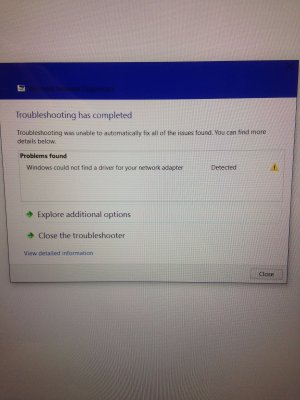

When I click next, it says
"Troubleshooting has completed
Problems Found:
Windows could not find a driver for your network adapter"

I was planning to drive to the Microsoft Store to get help. But as a last resort, I decided to check the Device Manager again. (Remember, previously when I checked the device manager, there was no entry for "Network Adapters" -- see my previous picture.) This time, however, "Network Adapters" was on the list! This was a big surprise. It had a yellow triangle over it, so I right clicked it and chose "Update Driver Software". This time, it gave me a list of two identical Marvell drivers to choose from (probably because I ran the installer at least twice yesterday). I chose the second one of them, and after a minute, my Surface Pro 3 was able to locate networks again. I connected to the school WIFI and was back in business. Hurray!
