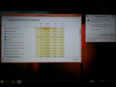

I am trying to play Diablo 3 on the 128 GB surface pro 2, but I keep getting low on memory errors. Performance isn't good either with lots of stuttering and hiccups. When checking task manager it says it is only using about 600MB RAM... I also lowered settings with no improvement. Could the RAM be bad or is this expected performance level?

Its playing better on a more stable internet connection but when I go back to the desktop there is still a low memory error asking me to close programs. Anyone get this on a 4gb ram surface?

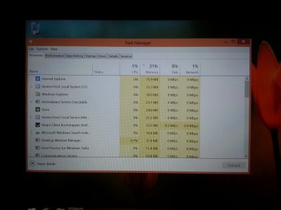

Not sure what you mean by high performance.... all settings are low. There is nothing running in task manager... but I noticed with 400mb of physical memory reserved it says I have consumed 30%....that would indicate it is only seeing 2MB ram?
Can someone with a 128 GB pro tell me how much of the physical memory is used with nothing open?
I get that too, and mine is the 256gb/8gb ram model. I also get it on my desktop sometimes, which has 16gb of memory, since upgrading to 8.1. I think it's just 8.1 being overprotective. I just hit cancel and keep on.

That was a 256 8gb....not sure if that compares exactly. Turned on high performance and still got the error...kinda irritating. Anyone able to tell me if their physical memory shows the same with nothing open per my pics. 128 4 gb version.
