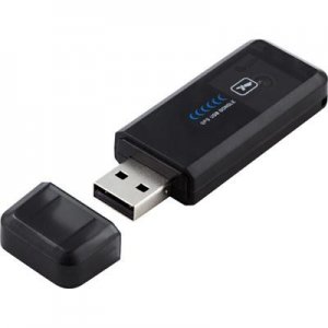

The Surface Pro, Surface Pro 2, and Surface Pro 3 have an onboard accelerometer, gyroscope, and digital compass. But it does not have GPS.
I've been using the GlobalSat ND-100S GPS dongle for my GPS on my Surface Pro 2 for months. When I need to track actual GPS, it works great.
Less than $30.00 from here: Amazon.com ND-100S Dongle - GPS for Surface.
Update: Also works on Surface Pro 3

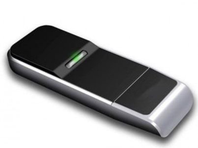

An alternative is the Canmore GT-730F, with similar specs and price. Gets good reviews, but I have not tried it myself. Also less than $30.00 from here: Amazon.com Canmore GT-730F - GPS.
Both these devices work as a dongle without a USB extension cable. Older technology devices required some space between the computer and the USB dongle because of electronic interference. Though a USB extension cable is not needed, I do not like having a stiff device poking out from my Surface inviting some trouble. So a short USB extension cord comes in handy.

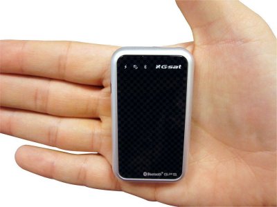

Back in the day when I had a Pocket PC I had a great GPS gizmo as well, but it worked via Bluetooth -- is there nothing like that now that works with the SP2? I'd rather not use a USB one at all unless that's all that is compatible.
There are many Bluetooth GPS devices available. I used one with a mini Sony PC about ten years ago. Power consumption is generally an issue, though, so plugging in somewhere nearby to operate or recharge is necessary.
Here is the GlobalSat BT-368i, available for about $60 from here: Amazon.com - GlobalSat BT-368i.
