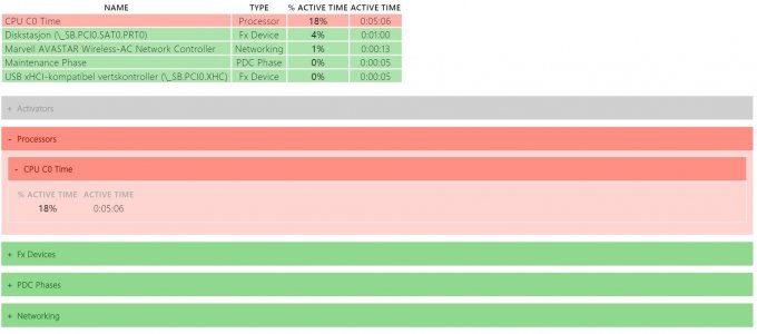

Below the part of the report you posted is a section called Activators which can help drill down further what is causing the components to stay awake ....
Doesn't look like any information is found there unfortunately:
I have tried to create a new Sleep Report today, but only get the "same" with the Connected Standby's from yesterday?! Anyone know how I get a report from the latest ones??
