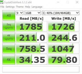

It is nice having the battery capacity back, maybe even better then ever. I used it, keyboard attached, for about 4 hours this morning. Just general web surfing and reading. After about 4 hours it still shows 49%. So close to 8 hours was likely. I don't ever recall it being that good.
Plus I can now put all of my media on the new large drive. I used to have it stored on the SD card, so you couldn't access it if the keyboard was disconnected.
BTW, I forgot to run CrystalDiskMark before, to get a before and after speed check. Does anyone happen to have the disk speed results for a Book 1, 256GB?
