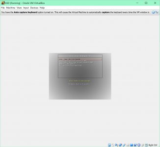

Okay everyone, I tried the VM. Going off of instructions from How to Boot From a USB Drive in VirtualBox for reference, downloaded VirtualBox and followed the instructions. I was able to get to the very end where I'm supposedly able to boot from the USB. It's definitely recognizing it, but my issue is it looks completely different than how it looked when I booted it the other way. It won't let me select any of the options and it never boots up automatically. I was only able to even move the selection highlight once and I'm not even sure how I managed that. So maybe making progress, just have to figure out how to proceed from here. Screenshot for reference. Again, thanks so much to everyone for the input! Would have been completely lost (kind of still am ;)) without it.

It looks like you're making good progress. Do you have the option to use your mouse to select the proper StartUp option? This definitely has the advantage that you're not sacrificing your normal computer behaviour and you don't need to fiddle with stuff you're perhaps not familiar with.
