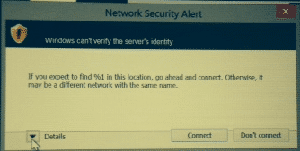

We also tried by disabling NAM and connecting via the Windows Client and received the following error:
___________________________________
"Network Security Alert"
Windows can't verify the server's identity: "If you expect to find %1 In this location, go ahead and connect. Otherwise, it may be a different network with the same name"
_____________________________________
This is typically a cert error and you need the cert installed (which it is).
We do use a certificate to ensure that we are connecting to a trusted wireless connection, and this certificate root is installed on the machine. The authentication type is PEAP [WPA2][Auth(802.1X)]. Cisco WLC7.6.120.0

On your particular issue, If you disable NAM can you connect, could it be a corporate firewall preventing you from accessing what you are trying to access?
I cannot connect to the protected portion of our corporate wireless at all (as I stated it is EAP-FAST w/WPA2 Ent.), either through the built-in Windows Client or through the NAM. However, we too have an unprotected, hidden SSID guest network that the SP3 does connect to without issue. I want to be clear here, that the exact same same software setup worked without issue (save for the very strange Windows Store/Microsoft Account thing) and there was no certificate that was required for connections to proceed on either the SP1 or SP2.
I don't believe it to be a firewall issue as far as I can tell because the SP3 simply won't authenticate to the access point and therefore never completes a connection at all.
