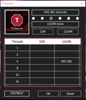

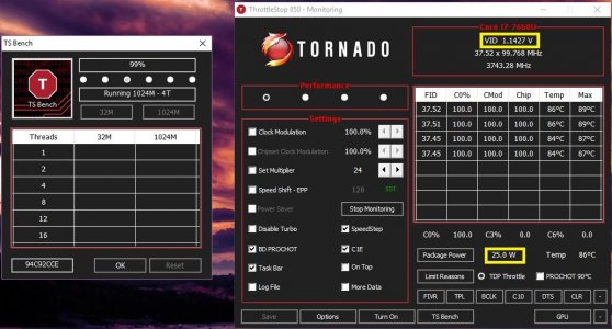

I like the program that they use (TS Bench from Throttlestop). I had to try it to my Surface Pro and was impressed that it literally maintained 25 watts (3.7-3.8 GHz on both cores @ 100% load) for the whole 1024 computation which took 455 seconds. If Surface Pro can maintain a 25 watt below 95 degrees (worst case summer no A/C) for 455 seconds, I believe SB2 should be the same. I suggest to bring this program too aside from Intel IPDT to check for thermals. I wonder how shorter is the computation time from SB2 15 on the same test.

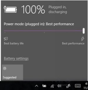

Did you set the power plan to best performance? This keeps the CPU frequency at max turbo which is 4-4.2 GHz for the 8650u chipUntitled.jpg
