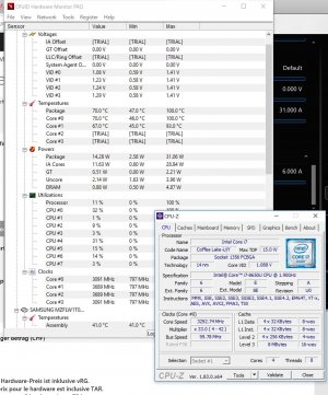

Well, it seems SB2 15" has indeed batches with bad CPUs. I myself got 1.41V in max VID, outrageous!
