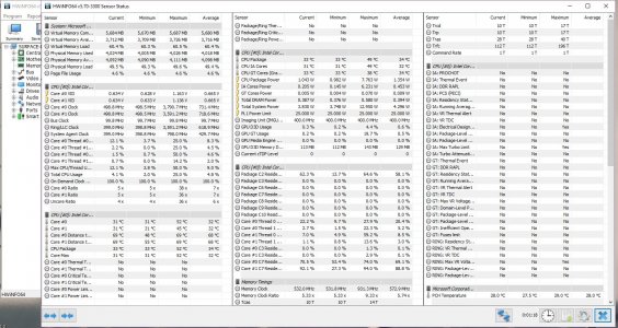

Has anyone with the 15 inch model actually tested theirs to see what cpu temps are like? I am able to use the machine, in fact I’ve tried running multiple stress tests just to see if it would crash or catch fire, and it kept running, even though hwinfo and Intel xtu said all 4 cores were pegged at 99-100c.

@ Mbernert - I am running into the same issue here - Bought a 15" surface book 2 a few weeks ago, noticed after a day that the cpu was reaching 100c while streaming video through the browser (netflix, plex) I was thinking this can't be right - started running tests using IPDT, and using temp monitoring apps core temp/real temp - needless to say IPDT kept failing with remarks to check the thermal solution - did a full wipe to factory, installed all updates - same results - took back to MS store they swapped me out with a sealed box - This unit appears to idle around 40c with the power mode slider all the way to the left (apparently MS calls this "recommended" ) once I set the power mode slider to the far right (best performance) idle temps go up to mid 50c while I simply type this post, however I notice two of the cores briefly hit 82c - also noticed VID jumps between 1.23 all the way to 1.35 and this was just using firefox with 3 tabs open..
Ran IPDT on this unit and also getting a failure with notes to check thermal solution :/ These temps seem awfully high for just web browsing and streaming video in a browser - Tried playing some games for a few minutes (half life 2, prey) and all cores hit 100c - didn't notice any lag or performance loss as the game was running fine, however - I am no expert with thermal design, but with those temps, it can't be good to hit the TJ max for any sort of duration - not sure if there is anything else I can do, short of taking this unit back to MS for a third try :/ -would appreciate any suggestions or some guidance here! if there are any other tests anyone would like for me to run please advise - Thanks in advance!

Seems like there are more "runaway" 8650U chips here with excessive voltages leading to very high temperatures. Anyways a 1.2 V constant voltage is way too much for just web browsing. A normal chip would've at least be less than 0.8 V when web browsing and less than 40 degrees at least.
I just got home with my now 4th exchange. Each of the last ones I have setup at the Microsoft store and had them watch while the system hit 100c sitting idle with nothing but hwinfo running. At first he said maybe it was hwinfo causing the problem so we uninstalled and tried intel xtu.
