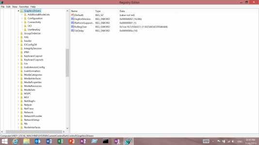

Well, the right thing to say is that I didn't noticed them but I found a bunch of them in event viewer!
I'm testing a registry change that claims to fix these errors.
It's the TdrDelay key shown in the above screenshot.
If anyone want to test it and I can say that at least it doesn't break anything. I have it for around 2 hours, I have restarted the S2 and nothing wrong has happened.
I'd be willing to give it a try. I'm not sure I understand the instructions though. What do I do with TdrDelay?
