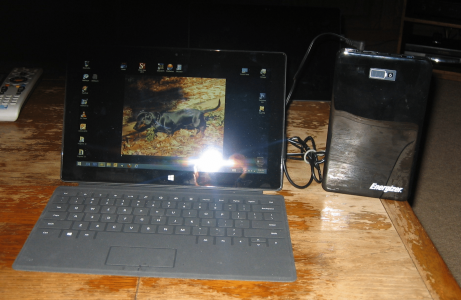

I have not tried MikeGyver's product, although it looks like a good one. A couple of people here (Bertopl and BjornB) have done homegrown variations of it, and, as of tonight, you can add me to that list. I started off with a leftover battery from a laptop, but it's still on my bench. Along the way, I decided to get this 18000 maH battery from Energizer. My original objective was to provide my Ladyfriend with enough battery to get her Surface Pro across the ocean to China. This will almost do it, but only if she takes time out for a nap:
I bought a car charger unit on eBay, just to get the Surface adapter, then found a compatible plug in my collection of unloved AC adapters. A little wire-stripping and soldering later, I have a plug-in connector from the battery to the Surface Pro (or RT). This should add 4 to 5 hours to her usage time, depending on what she is doing.
I didn't see MikeGyver's product until after I had already ordered the parts for this unit. Next, I have to invent a really clever connector for the leftover laptop battery.
Film at eleven, or maybe later.

Russ, now that you finished the batt- nice job by the way, You can really focus on a sand and stain for that table in the pix. :wink:

An interesting observation about the battery and the Pro. I have my Pro on the "Never/Never" setting when plugged in. The desktop battery icon read "Plugged in, but not charging." So, the Pro knew it had external power and was using that source, rather than its own battery. I left it on last night, and, when I got up this morning, the external battery was completely discharged and the Pro had gone into hibernation. Once there was no current coming in from the battery, the Pro decided it was "not plugged in" and followed that power scheme.
The battery weighs 1.1 lbs and the cord is negligible, so it's not too much burden for the extra hours of usage she gets on the flight. The AC unit is cumbersome, as they usually are, but I will buy an extra charger, so she can have one here and one in her Shanghai condo. That way, she can have a fully charged battery for the flight both ways, and not have to lug the charger around. Sounds like "coals to Newcastle," huh? The unit is made in China, so I buy it here and send it back to China? Hmmm? Might need to re-think that.
Thanks, Tony.
That table may be older than you. It still does what a table is supposed to do -- it just ain't pretty anymore, as that picture makes glaringly obvious. I use that table every day, but must admit to being a little surprised at how awful it looks in the picture. As a bachelor, I am more than perfectly capable of ignoring it's looks, as long as it does what it is supposed to do. It's even funnier when you consider that I am a very competent woodworker, and could do the job easily.
I was going to tell her about the battery, and send her the picture. That's a bad plan. I think I'll take a new picture on the workbench in my shop.
