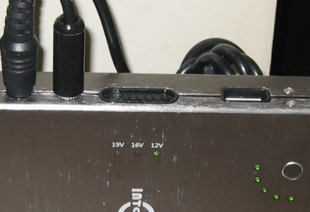

I now have one. Earlier, I bought an 18000mAH battery from Energizer for my Ladyfriend. Since the Intocircuit battery is 26000 mAH, I decided to get that for her, and keep the Energizer battery for myself. There is one thing I really don't like about it. The Energizer battery has three different receptacles (using different connectors) for the different voltage levels. The Intocircuit battery has one receptacle and a slide switch to choose voltage level.
That is just trouble waiting to happen. After being jostled and handled, that slide switch is bound to move, even though it is recessed, and, sooner or later, the Pro gets a 19V jolt. (Yeah, I know, one should pay attention, but after 18 hours of flying, that can be hard to do.)
If I do give her the larger battery, I will block that switch so it can't move, and then put a piece of tape over that.
Anyhow, just FYI.

I began this project originally by purchasing two cheap RT auto chargers on eBay, just to get the Surface power connectors. The first project (the Energizer, posted previously in this thread) was easy, because I found a connector in my collection that perfectly fit the 12V output on the Energizer battery. Then it was just a matter of clipping the connector off the RT charger, some stripping and soldering (and a little shrink tubing) and it was done.
Both the Energizer battery and the Intocircuit came with a wide array of connectors, most of which I now have no use for, so they just go into my collection.
Again, I found a connector that fit the output receptacle on the Intocircuit battery, so it was just more wire stripping and soldering. There are only two wires to deal with -- the positive and the negative. Once you have those established, the rest is just mechanics. If you have any detailed questions, just post them. There are a few of us here who have done this sort of thing already.
