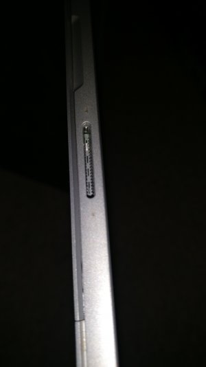

Yeah I also think it's the port. I've blown it out and really looked around but can't see any damage.
I can't find a picture online of how one should look like OR how they work. All of the pins in the port look like they are flush with the case. When the the charger is received into the port do the pins get pushed out? Does anyone have a pic of their port? I'm having an absolute nightmare as both my laptop and surface have broken in the same day! Thanks for the replies!
Your port looks okay, but one of the pins may have a coating of tarnish, adhesive residue, grease, etc. picked up from somewhere. It happens ...
I've included a picture of my Surface Book 2 15" port. Same. Works by slightly pushing pins outward. Pins on both sides are to the same circuit, allowing the connection to be made upside down with no problem.
Try wetting one of your connectors ever so slightly with isopropyl alcohol, then making a connection. The idea is to gently wipe the pins with some alcohol, removing debris.
