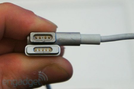

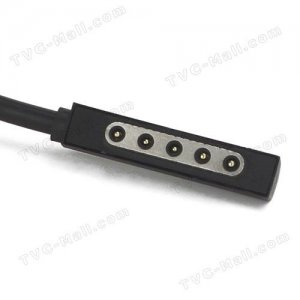

I think all they really need to do is round the edges of the tip and make the tip a little wider and it will slip right in. The sharp edges tend to catch too much instead of slipping in and the slot is a little too narrow.
Rounded:
Sharp:
