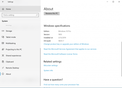

I am running Windows 1903 and much to my pleasant surprise, both my Surface Book 2 and Surface Pro 4 are running noticeably faster and seemingly more stable. This combined with many visual (GUI) upgrades - means good things are headed to Windows Pro users.
