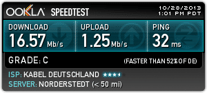

my Surface Pro 2 (8/256) has the same problems. Wireless performance is awful. An HP Elitebook 8570p maxes out the 300 mbit and has full bars in the same position, while my SP2 gets only 2/5 bars (4 meters away from the router) and no more that 54g. Seems to be a driver issue in conjunction with an awful wireless chipset concerning older posts for the SP1. I'm on the latest driver and have tried two different networks.
Another thing to look at is if there may be a Firmware Upgrade for your router, as the Marvell Chipset is still fairly new. There has also been reports that the Marvell Chipset overwhelms some routers and by lowering its power in the advanced settings improves throughput.
http://www.speedtest.net/result/3063518632.png
I've switched the router band to 5 ghz and now it displays 270 mbit wireless connection internally. The above results are from my 100 mbit internet connection, which normally nets me upwards of 75 mbit/s via ethernet. it has to be the surface. my router (Fritzbox 7270) is on the latest firmware. I'll wait a month for updated drivers and otherwise return it for an exchange. I've already invested 300 € into accessories so I definitely won't be switching to a Vaio Tap 11 ;)
