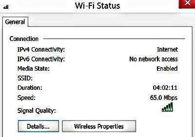

The Marvell WiFi card (in the SP2) sure seems to be a bottleneck re: transfer speed. The network dialog consistently shows the built-in card at 65 Mb/sec. However, using a low-end DLink USB adapter shows speed of 150 Mb/sec accessing the same router signal.
I wouldn't call using a USB adapter much of a "solution", but in some instances perhaps a workaround to employ. We certainly can't replace the internal adapter, though probably a lot of people wish it was possible. I'd be among the first in line...

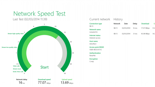

This pic shows my network performance on my SP2 in 2.4Ghz and in 5.Ghz mode ... this is consistent with what I get on my Macbook Pro and my Lenovo X1 Carbon. Router is an Asus RT-n66u ... Bluetooth off ... Bluetooth on indeed makes 2.4Ghz speeds drop like a dead fly. 5Ghz speeds are unaffected.

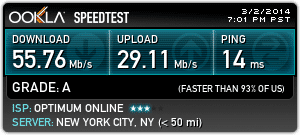

I'm on Optimum Cable. Here's my SP2 connected to a Linksys E3000 router over 5Ghz:

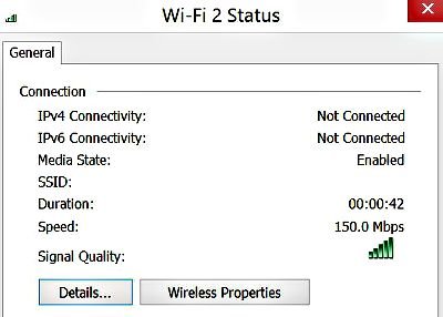

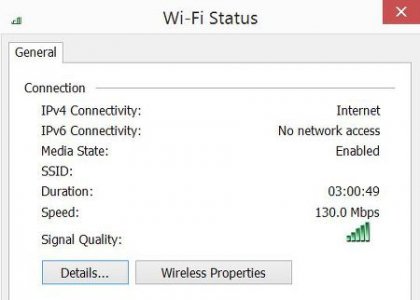

1. Marvell 2.4GHz WITH Bluetooth
2. Marvell 2.4GHz WITHOUT Bluetooth
3. DLink USB Dual-Band 2.4GHz W/WO BT
So, yes, BT certainly interferes with the Marvell WiFi, though curiously had no effect on the external USB DLink adapter.
