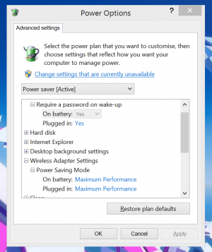

Side note for every one new to the Surface, the only time I've ever had wireless issues was when on battery. This was remedied by ensuring that in my advanced power settings, for whichever power plan I'm using, that the wireless adapter settings were set for Maximum Performance. Problems are now very, very rare.
