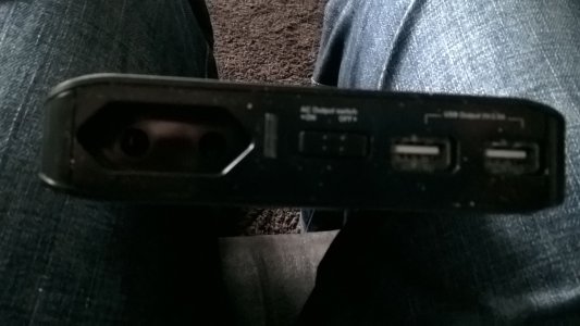

Xtorm AL 390 with 110-250V output, just have to plugin your own charger ;-)

TBH I don't know if an m3 will charge with a 12v charger I never tried it. I did try (accidentally) charging an SP3 with an m3 charger and it didn't charge. I only did it once and decided to be more careful and never repeated that experiment to verify. It didn't damage anything but I had to remove the m3 brick from power and plug it back in to get it to charge the m3 so it apparently did a safety shutdown.
Hmmm it seems like the charger does have a safety cutoff which kicks in when it can't provide enough power it used to happen to my pro 3 charger and also happens to my pro 4 charger when I try to charge the surface and a device which needs more than 1 amps through the extra usb port on the actual charger brick. The charger would just cut out and the white light on the charger connector for the surface would just keep blinking and the only way to fix it was to unplug the charger from the mains and connect it again and also to disconnect the usb device from the the charger brick.
