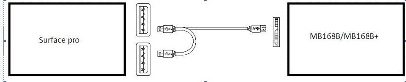

I have been in touch with ASUS tech support regarding the MB168B+ (the 1920x1080 version; MB168B is the lower-res monitor). I had the same on-again-off-again issue whereas it works great with my laptop. I also tried manually splitting the cable with a Y extension but that did not work.
They sent me the following picture of how the monitor is to work with a Surface. I purchased a USB3 Y cable, on its way here in a couple of days, and will report back as to how well it works.
My lower-res monitor (Lenovo) works fine though.
