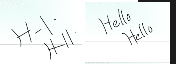

I'm having problems with annotating using the pen when using the Reader app included.
When I first start, it runs well. The notes being written is very similar to my pen strokes. But after a few minutes of writing, the writing produced becomes more angular... To remedy this, I'd have to write really really slow for it to accurately register what I'm trying to write. Or I'd have to restart reader by closing it on the Task Manager.
For comparison, this what it looks like after running it for a while and the one on the right is what it looks like after a fresh restart

OP: What happens if you hover the pen above the screen so you can see the pointer when this is happening? Does the pointer smoothly follow the pen nib or does it jerk around?
What happens if you are inking in OneNote for the same sort of time? Same thing?
It sounds like it could be a low AAAA battery in your pen. When it happens try removing the AAAA battery, waiting a second and putting it back in. Does it work any better?
The pointer is following the pen smoothly although a little delayed.
If I write in OneNote, it doesn't suffer from any lag or anything. I've spent like 30 mins drawing something in OneNote and it was still smooth. The problem seems isolated on the Reader app. I was using powerpoint before and it smooth all throughout the lecture as well.
I also tried the battery thing and it was still the same. I've checked the review for the Reader app in the MS store and I saw someone else was having the problem with annotating. :(
