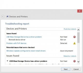

Tried that to, under: "Control Panel\Hardware and Sound\Devices and Printers" sub category "Unspecified" : the surface recognize the device.
When i Press "troubleshoot" - > after "detecting problem...." I've tried all the options, none of them works, saying:
USB Mass Storage Device has a driver problem Not fixed Not Fixed
There is a problem with the driver for USB Mass Storage Device. The driver needs to be reinstalled.
Informationa lDevice information
Name: USB Mass Storage Device
Error code: 10
The irony is that the device is recognized at my desktop and my laptop and works fine there.. so i guess it's not a driver error one. here is a print scr of the error, maybe it will help. Untitled.jpg

Problem Solved!
1. Connect and switch on the device with the HD to a PC running OS that is not Windows 8.1 (I used XP).
2. Download and Install the Firmware at: http://www.orico.com.cn/file/ORICO%206518SUS3(%20%E6%94%AF%E6%8C%81win%208.1%20)%E5%9B%BA%E4%BB%B6%E7%A8%8B%E5%BA%8F%E6%9B%B4%E6%96%B0.rar
3. Follow the Instructions in the File.
4. Switch off the Device
5. Connect it back to the Surface pro windows 8.1, and Enjoy.
Many Thanks to Ken from Customer Care Division at ORICO.
