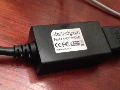

I use a Mini DP to HDMI cable to drive a 23" Dell Touch Screen Monitor S2340T that someone on these forums suggested. Its max Resolution is also 1920x1080 and the resolution is VERY CRISP, VERY CLEAR. Attached is a picture of the adapter I use. StarTech.com MDP2HDMI < - Great Part number eh? J5150P is absolutely correct about VGA, its bad and should not be used unless its the only option for a larger display. If the larger display you have does not support DVI or HDMI or DP, I would consider upgrading when $$Flow allows.
