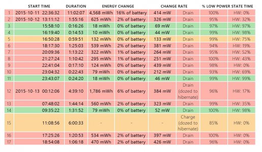

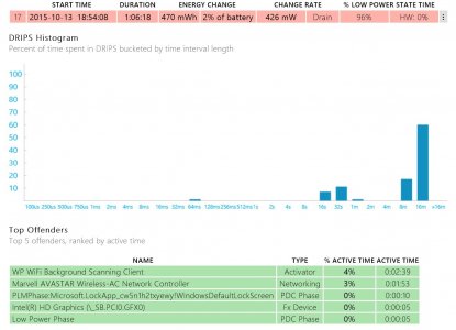

Here's a couple of screenshots of my results.
Nope. I just disable the adapter when I'm not using the Surface to conserve power. It sucks that I have to do that, but nothing else I've tried works consistently. Even with the adapter turned off I still have times where it uses over 10% over night., but when I check the sleep study report it shows everything green.
