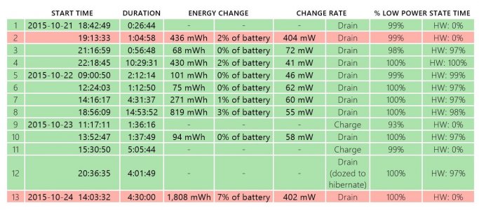

Here's my sleep study for the last few days. Hibernate definitely seems to play a part.
I haven't changed the hibernate time yet, but for some reason, my surface has been refusing to hibernate anyway. As you can see, apart from the top 2 readings, I've had no problems at all the last few days, until it finally decided to hibernate. Then, it started draining again during sleep.
I did restart the surface after reading number 2, as once it starts draining a lot during sleep, a restart seems to be the only way to fix it. Also, reading 1 showed no value for drain which is a little weird. Apart from that, the machine hasn't been shutdown or restarted.
