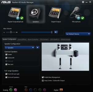

Not really. I am running Realtek 7.1 Surround Optical out to my Denon amp. It also has a 5.1 option.
I see that you have Realtek disabled. Have you tried it? I also have Nvidia option, but prefer Realtek.

I have tried it and when every I switch to 5.1 I get no sound. You appear to have a totally different realtek audio manager than I do. That might be one of my issues, any chance you have a link to download that version?
Mine looks like this
I keep reading on multiple forums that Windows 10 doesn't support anything above 2 channel sound through any device, optical or HDMI, but if you are getting 7.1 then they are wrong.

1. I can run either 7.1 or 5.1 and get sound on both.
2. I am running it on an Asus Z-87 Deluxe. Download link is: http://www.asus.com/us/Motherboards/Z87DELUXE/HelpDesk_Download/

Have the Asus x99a, I have tried every version of the driver I have could possibly find and not one would let me use surround sound. I will try and download that audio manager but I am currently running a newer version of the driver. This is driving me nuts. I really appreciate the help.
must be my motherboard because it gives me the same, less functional, interface.
Hi, Kris --
There should be more options on that interface, e.g., Speaker configuration. Have you tried settings (the gear icon) or other choices on the dropdown for "Set Default Device."
This is what mine looks like on a P9X79 Deluxe, which is my shop computer:
That is with Driver #6.0.1.7535, which is later than the one on the Asus support site (which is, in itself, interesting). I have another P9X79 in Ladyfriend's office in the house. I will try it later on the 7.1 setting. I also have some other Asus boards, but all earlier than your X99A, so don't know if they would tell us anything interesting.

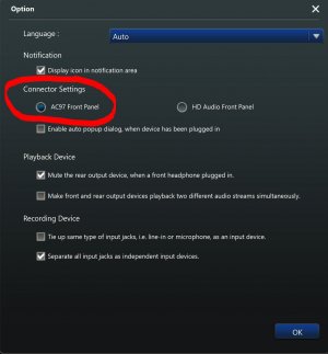

Thank you I didn't even notice that little gear icon. The only way to get the speaks to show up is if I switch to AC97

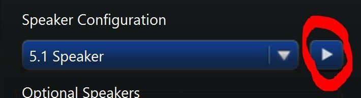

Then I get this screen
but when I press on the play icon to test the speakers I get no sound
