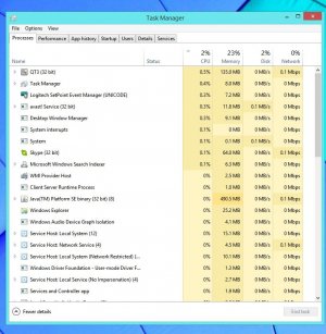

I restarted the Sp3, I just left the intel extreme tuning utility and task manager open, I went to supermarket for 20 minutes, when back the result is this, never a spike of cpu, the minimum temperature is 46 c. without air condition, in house we have around 28/29 I think. With air con however I don't think can go down more than 45... because is a closed pc so have few impact just 1/2 degree I can lower house temperature.

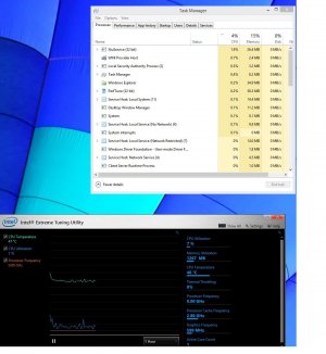

this morning while I was in bathroom system went up 35%....... what I changed? I disabled this morning before it happened the "setpoint" utility of Logitech. I will update today..later. I enabled it again, if the issue stop then in my sp3 was not the realtek audio driver but something in Logitech devices that needs absolutely this utility to fix some conflict with windows. I read in fact in many post of Logitech users that they wait a lot to have some fix about system process in the task manager. So may be there the cause. We will see! otherwise..........RESET :) Final day, final table :)
I disable the utility of Logitech because I have seen that one using 0.2/0.5 cpu some time, so I said, why to keep it active? for sure updated the drivers, so I quit with it. After that started again System to to go up when I leave the pc 3/5 minutes idle. Now I enabled it again but System give problem yet, I think I need to reboot first and then to test again if it was the issue.
As I was thinking.. I needed to REBOOT after I enabled again the "setpoint" utility of Logitech to manage the bluetooh devices, the Logitech ultrathin mouse and the keyboard k810, both very nice devices... As I read in one of the hundreds reasons of people with the SYSTEM issue, a guy had in the house over 8/10 devices of Logitech and was very angry at Logitech that had this issue with Windows 8.1 or so, and I read that they was waiting months for a fix to the issue, and I assume now it is fixed. I leave to EXPERTS to explain why if you start windows with this utility already active since the start up you will not have the issue anymore, and/or why if you disable the utility and the enable it again in the current windows session this could stop the fix to the SYSTEM going up when pc is idle.
I will continue the test the day!! as I said is the final day. In the mean while I'm making the RESET to another sp3 i5 just arrived and then we will add there the same programs and devices I'm using in my Sp3 i7.
Don't know how many of you are using Logitech and/or bluetooh devices, for now seem that my issue is caused by something in Logitech...
Confirmed, I left the Sp3 many times idle and SYSTEM is not going up anymore, I think that in my case was so Logitech the problem, and the unique way to don't have the problem is to install, use and load on start the "setpoint" utility that is a small control panel/settings for Logitech devices. It take from 0.1 to 0.5% peak max of Cpu, but resolve the issue, probabily without it the devices of Logitech are creating problems to windows. I leave to experts the conclusions and if so can be this the issue.
