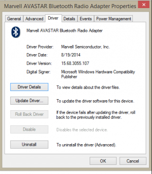

So is it ok to install setpoint or not? I have the k810 bluetooth keyboard but I haven't installed setpoint as of yet.
I have seen your PHOTO in the album right now. If you don't have any issue with task manager you can leave without, if you start to have I suggest to set up it. At the end you can set up at the best the mouse or some keyboard function, but if you are not having issues I assume that it's more the mouse to give issues than the keyboard, the mouse has more cpu intensive features seem (it's touch sensitive).
My K810 hasn't worked right since I updated to the latest SP3 Firmware. I'm losing occisonally losing connection between the k810 and my SP3. Also when I hit the Caps Lock key everything goes haywire. I tired installing the Logitech Setpoint drivers and I couldn't ever get the keyboard tab to appear. I know the keyboard works correctly because the keyboard pairs perfectly with my iPad. Any suggestions?
Is happening to me to! Since few days, I'm going mad, I also have SYSTEM issue again, I'm working like a Microsoft employee to fix the issue of my 1750 usd device :) Please KIF, open a specific thread about the Logitech Keyboard, so I will reply there and we keep there updated, we will wait from Logitech forums other users for a solution... I think happened all like you said after some update few days ago. This messed up again my SYSTEM process going up and now I'm confused, I have to open a new thread for SYSTEM issue because I have to follow another path for that now.
