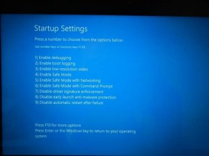

I am very frustrated. I tried different methods and non of them works. I hope you guys have a solution I'm not aware of.
I want to install unsigned driver on my Surface Pro (128GB, Windows 8 Pro).
I go to Troubleshoot > Avanced options > Startup Settings, and then the “Restart” button as described on this site (and many others).
However after PC restarts I am not able to choose anything. Simply my keyboard doesn't respond. I connected different one but same thing. Until this moment all works perfectly (and mouse as well). What more, my screen is different than the one from the link (black screen, oldskool DOS view):
I tried with function keys and with number keys, as well as with num block keys. Nothing.
My keyboards are not Type or Touch Cover, they are Ligitech K800 and other on regular USB cable.
I tried on Secure Boot enabled and disabled.
I'm run out of ideas.
At that point in the booting process it likely has not loaded a USB driver. You need a direct keyboard like the touch or type cover.

Solution!
I had the exact same problem and was also fuming about the oversight/plain idiocy from the Microsoft engineers, luckily I've figured out a solution.
Since there is a way to boot from a USB device, in this mode the USB port should be enabled (:P).
So- a combination of both advanced startup and boot from USB device mode should do the trick:
1) Do all the steps to get to where Windows describes what "Advanced Startup Mode" means and shows the "Restart Now" button as described here (right before step 3) Windows startup settings
2) Right after clicking "Restart Now", and before the device physically restarts, press the "volume down" key on the side of the Surface Pro. (This enables booting from a USB drive - and the USB port!)
3) Once the Surface screen is up you can let go of the "volume down" key
4) You should be able to use a USB keyboard with the Advanced Startup Settings menu :)
