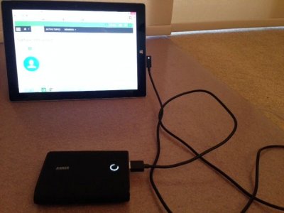

This Anker charger seems to charge well when used with the charging cable that comes with the Surface.
It charges fast enough when used with this that I can charge and use the Surface at the same time, but the best use would be charging the Surface while it's being stored in a bag.
The Surface charging cable is also best because it fits close to the body of the Surface 3 so the micro usb connection won't bend and get damaged in the bag.
