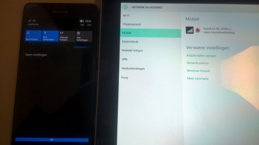

This morning I made a picture of my Lumia 950 next to my Surface 3 LTE both on the Vodafone network. One did have internet access and the other didn't. It is never the other way around.
