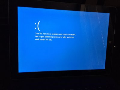

Yes i try the one click first, then sometimes when it doesnt work, i hold it down. For ex, i just did the one click now....it displayed the surface logo, then screen went black (instead of going to login screen)....BUT for the first time, since this has been happening, i just saw this below error....its still restarting...not sure if this will fix it, but this is first time ive seen this error.

It restarted the surface....i will keep an eye on when/if it turns off by itself again.
All I know from my own experience with win 10 and the S3, is that it shouldn't be turning off like this. It may be the case that you have no choice but to try a reset and keep your fingers crossed.
