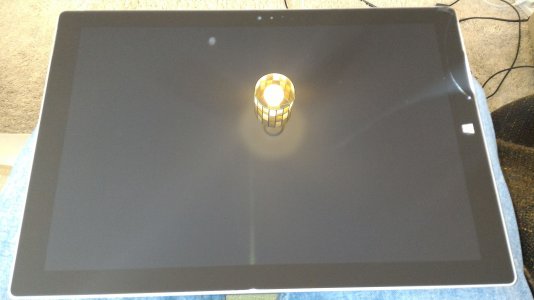

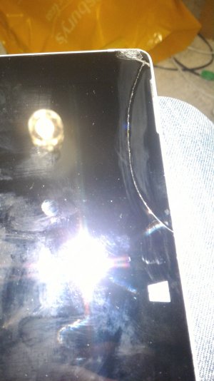

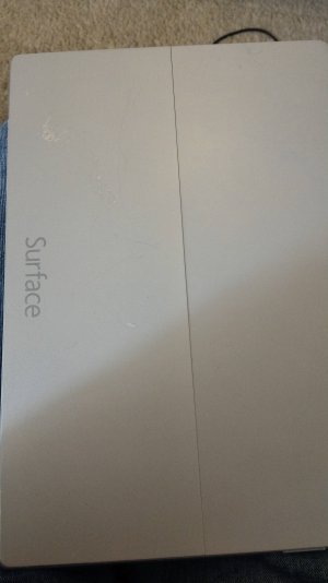

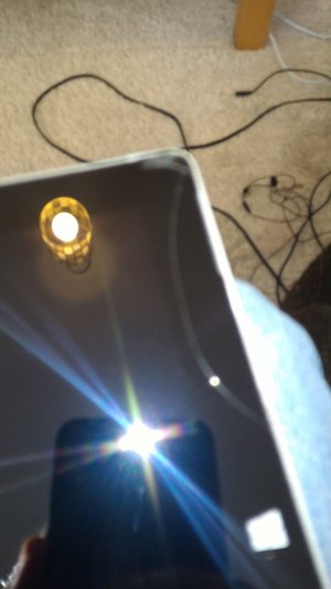

here's a pic to show you guys what i'm dealing with. So far i've superglued it, but i'm thinking uv loca glue over it, let it set hard, then get a stocker boy on the whole thing and i should be good to go. I know i'll never get it as strong as if it was new but even if it did spread i'm still sure someone would pay at least £450 for it, for uk market that is very cheap even broken.
But if anyone has experience with this please let me know, if it could do more harm than good i'd love some opinions.
thanks
p.s. all those smears are just grease by the way, even around the crack.

I thought about it but i think screen protectors lesson the user experience a little. I think glass glue should give a similar result then i can hide the mess with a sticker boy.

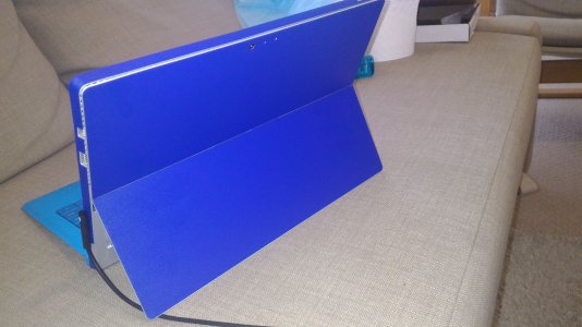

I've decided after some thinking to completely leave it, the cracked bit moved up and down freely with pressure independently of the rest of the screen, without causing any damage to itself or the rest of the screen. The last thing i want to is bond it to rest of screen then if i put pressure on it, it cracks the rest of my surface screen. Going to stick a skin on it and pretend it's not there i think :)

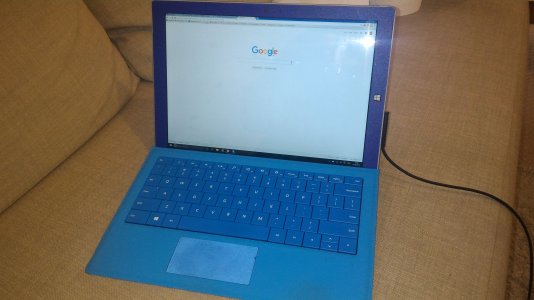

Transformed :D so glad I took a gamble on this ;)
