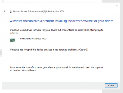

Tried to manually install also. But at the end of the setup it gives the following error.
I am having the same issue trying to install the newest driver manually... just get the error message "not valid for this computer". This is the only thing I am having issues with with SP3 :(
How are you installing it manually? The one linked through above worked fine;
